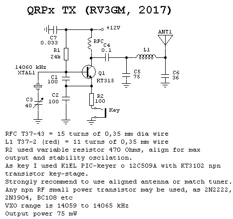

I guess, the power output is 10...20 mW approximately. You can increase the power if add RF choke instead of 1 kOm resistor and add Pi-network from collector to antenna. I've got about 50-60 mW with 9V battery on this TX scheme
I love QRP-X power very much! (less than 100 mW). My personal results are 58 Countries and ODX 6092 km distance. Enjoy it!

I try add the choke... the pi network no reduce power?, and other question... if put a GND with the original Ten Transmitter circuit the oscillation stop, whay is that? (i think is some match impedance issue) you have some idea?.
Thanks!!
Paraset transmitter for the poor spy 23 Ноя 2022 16:28 #59119
  • Сообщений: 2212
  • Репутация: 233
Dear Emilio, The good chocke and pi-network did not reduce the power. Backward, it increase output, sure.
To fix the oscillation stop you can to match .001 cap and 100 kOm res carefully. Me, I don't like your scheme, it's not steady and stable oscillator. I'd like to recommend classic scheme with two cap's in feedback between base, emitter and "ground" points (see my QRP-X TX above). No any problems with oscillation with it.
